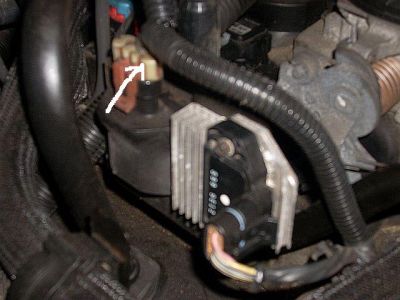

My son has a 1999 Chevy S-10 4.3L V6 and wants to add a tachometer, I do not see a standard coil (round type) and was wondering where I hook up the wire for the tachometer to receive the RPM information.

[img:4e52cd7c43]http://www.2carpros.com/forum/automotive_pictures/190976_Bens_S10_007_1.jpg[/img:4e52cd7c43]

[quote:323d933014="mastertechtim"]grAB THE WHITE WIRE AT THE IGNITION MODULE[/quote:323d933014]
I attached to the WHITE wire of the plug on the ignition model this plug has a 2 wires on it a white one and a pinkish one.
I do get signal but it seems low, curb ideal in park 5-600 RPM's Cold.
There is another plug on the igition module with 4 wires going to it and this also has a white wire.
Any assistance would be helpful.

the white wire at the coil is the right one. make sure the setting on the tach is set correctly.

Please see attached photo with the white arrow of where I attached the tachometer wire. I have verified that the tachometer is set to 6 cycl. Please give any advise on why I am reading low RPM's.
https://images.2carpros.com/forum/automotive_pictures/190976_Bens_S10_008_2.jpg

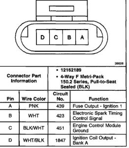

grab the white wire at the ignition module, its right next to the coil. let me know if that works ok
https://images.2carpros.com/forum/automotive_pictures/139033_coil_1.jpg

I attached the wire from the Tachometer to the White wire (pin B).
Sunpro Tachometer reading the same RPM's at Curb ideal in Park 500-600.
Any Idea's ?
