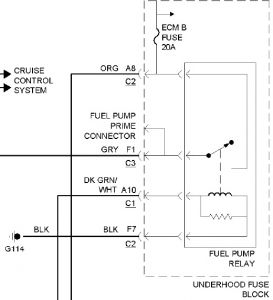

where is fuel pump test terminal located on 1999 chevy. s10. I have a repair manual can not find it where the manual say it is.

Don't have exact location. If you unplug the fuel pump relay and use a jumper wire between the orange wire terminal and the gray wire terminal, the pump should run. Orange wire terminal is hot all the time. The terminal letters are in the diagram. Right now I'm having trouble posting the diagram, I'll try again in a bit.
https://images.2carpros.com/forum/automotive_pictures/170934_99_s10_fuel_pump_1.jpg
