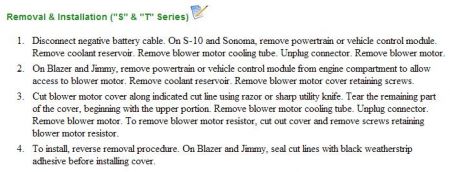

How do you replace a heater/ac fan motor on a 1999 chevy s-10 pickup. Thank you very much

https://images.2carpros.com/forum/automotive_pictures/261618_Noname_1652.jpg
