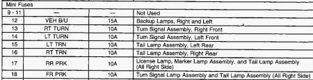

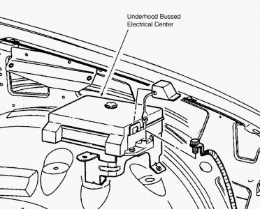

All 4 turn signal lights do not work. Could it be the flasher-unit, and if so, where is it located.

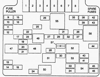

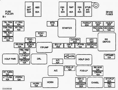

Find the Underhood busses electrical center(UBEC) Here are the fuses and fuse numbers.

Thanks for getting back to me so fast. I checked the appropriate fuses and they were OK. How about the Signal-light Flasher-unit? And where is it?

Behind the right side of the dash, possibly behind glove box.
