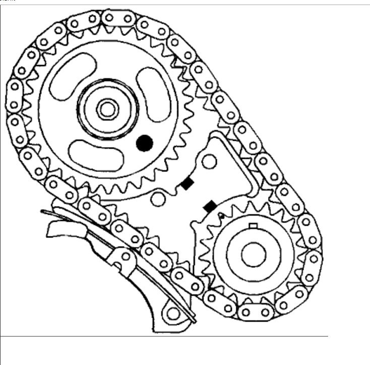

I just rebuilt a 2.2l in my employees car. Engine timing marks were on the nose and dialed in for #1 top dead. When we fired up the engine it acts like the timing is advanced a tooth as the motor shudders/shakes heavily while it runs. I know that the timing gears and chain were dead on at assembly. I also now that if the timing was retarded a tooth we would get popping and sputtering out the pipe. We have none of that. There is no mechanical noise when she run but the shudder is very pronounced. There is no distributor on this, instead there is a cam position sensor. Also the check engine light flashes red. I can not find anywhere to adjust the timing on this engine. I am a seasoned mechanic and it feels like the timing is roughly 15-20 degrees advanced. Its like the engines fires on the upstroke and the combustion tries to stop the upstroke of the pistons. Not enough to stop it from running tho. Can anyone tell me how to adjust the timing on this vehicle. I also got the plug wires running 1, 3, 4, 2 with #1 being closest to radiator. Thanks for any advice you can give.

According to Alldata:
the reluctor wheel is an integral part of the crankshaft and the Crankshaft Position (CKP) sensor is mounted in a fixed position, timing adjustment is not adjustable.
What codes are listed in the computer? Maybe we can take a different angle on this.
I assume you have a scanner to read data, or no?
Recheck that all connector plugs are back in to the sensors.
We need specs to work with.
Check the fuel pressure, injector pulse and vacuum.
Here is a timing diagrams so you can check it (below)
