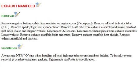

Need information not found in my repair manual on how to remove and replace cracked exhaust manifold on the drivers side of my 98' chevy S-10 with A/C. I have removed bolts and header pipe, spark plugs, and upper control arm and still cannot get the manifold out past the steering shaft. Any advice would be appreciated. Thanks, David
