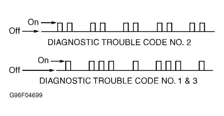

i have a 98 s10 zr2 that i have had to do a little work on but is overall in pretty good shape. my four wheel drive has not engaged to high range in a couple years but low range worked fine. recently when you push the button to engage it both the high and low range lights come. it does lock in but you can only go about 5 mph at 2500 rpm. after that its like it doesnt know where to shift to.

SELF-DIAGNOSTIC SYSTEM RETRIEVING DTCS NOTE:Diagnostic Trouble Codes (DTC) are displayed on 3 transfer case shift select buttons. When proper conditions are met, select buttons will blink to indicate DTC from "1" to "4". Turn ignition off for at least 6 seconds. Locate DLC near right side of steering column. Install jumper wire between diagnostic pigtail (Orange wire at DLC, terminal No. 13) and ground. Turn ignition to run position (engine off). Observe shift select buttons. If all shift select buttons blink once at same time then stop, no DTCs are stored. If only one code is stored, that code will blink repeatedly, with a 3 second delay between sequences. If more than one code is present, next code will flash after a 3 second delay, then sequence will repeat. Count number of blinks for each code. See Fig. 1. Write down all DTCs. After retrieving DTCs clear TCCM memory and repeat procedure. See CLEARING DTCS. If DTCs return, perform appropriate DTC test. SELF-DIAGNOSTIC SYSTEM RETRIEVING DTCS NOTE:Diagnostic Trouble Codes (DTC) are displayed on 3 transfer case shift select buttons. When proper conditions are met, select buttons will blink to indicate DTC from "1" to "4". Turn ignition off for at least 6 seconds. Locate DLC near right side of steering column. Install jumper wire between diagnostic pigtail (Orange wire at DLC, terminal No. 13) and ground. Turn ignition to run position (engine off). Observe shift select buttons. If all shift select buttons blink once at same time then stop, no DTCs are stored. If only one code is stored, that code will blink repeatedly, with a 3 second delay between sequences. If more than one code is present, next code will flash after a 3 second delay, then sequence will repeat. Count number of blinks for each code. See Fig. 1. Write down all DTCs. After retrieving DTCs clear TCCM memory and repeat procedure. See CLEARING DTCS. If DTCs return, perform appropriate DTC test.
