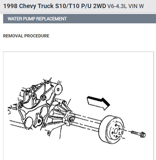

My truck started smoking a little before I got to school and when I got here I opened the hood and noticed that I was leaking antifreeze all over the place. It looked like it was coming from the water pump?
Tuesday, February 26th, 2008 AT 7:36 AM
DANNY L
  • 5,648 POSTS
Hello, I'm Danny.
The best way to test for leaks is to perform a cooling system pressure test. Without the car running it pressurizes the system with air and you can then see where leaks are coming from. Here is a tutorial showing how to perform a pressure test:
https://www.2carpros.com/articles/radiator-pressure-test
If the leak does turn out to be coming from the water pump here are a few tutorial showing how to drain and flush the coolant as well as how to replace the water pump:
https://www.2carpros.com/articles/coolant-flush-and-refill-all-cars
https://www.2carpros.com/articles/water-pump-replacement

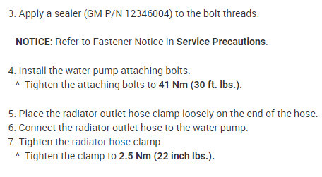

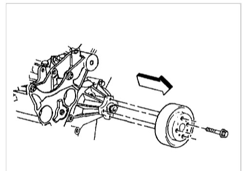

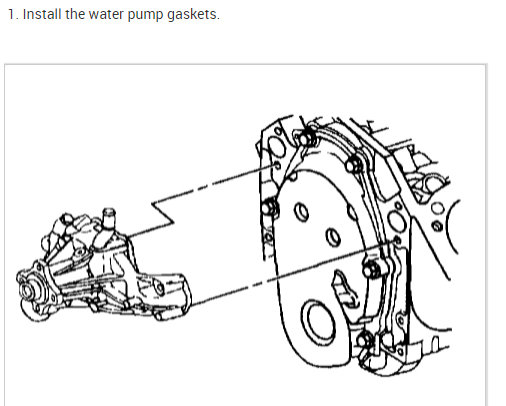

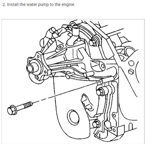

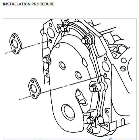

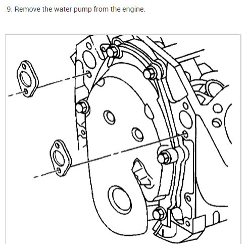

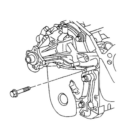

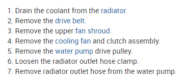

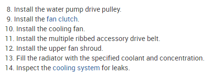

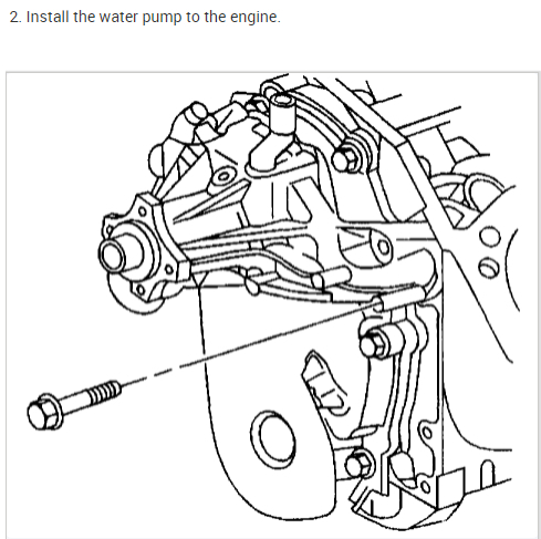

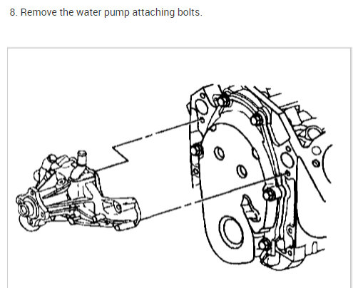

I've attached picture steps below on how to replace the water pump on your S10. Hope this helps and thanks for using 2CarPros.
