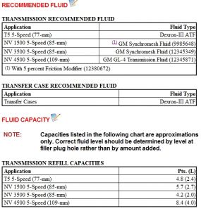

When putting in new clutch and pressure plate what type of transmission fluid and how much do I put in.

Apr 25, 2010 at 6:54 PM
