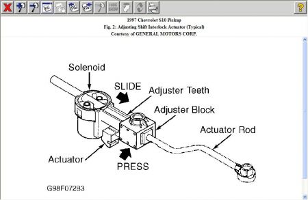

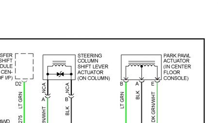

went to get in the truck start fine got going. forget something at the house turn around. turn off truck the went in side, came out started truck, then tryed to but in gear stuck in park. please help

You have a problem with the shift interlock system-could be the shift interlock actuator
https://images.2carpros.com/forum/automotive_pictures/12900_actuator_2.jpg
https://images.2carpros.com/forum/automotive_pictures/12900_shift_lock_actuator_1.jpg
