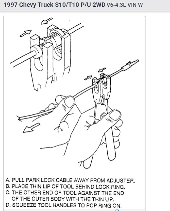

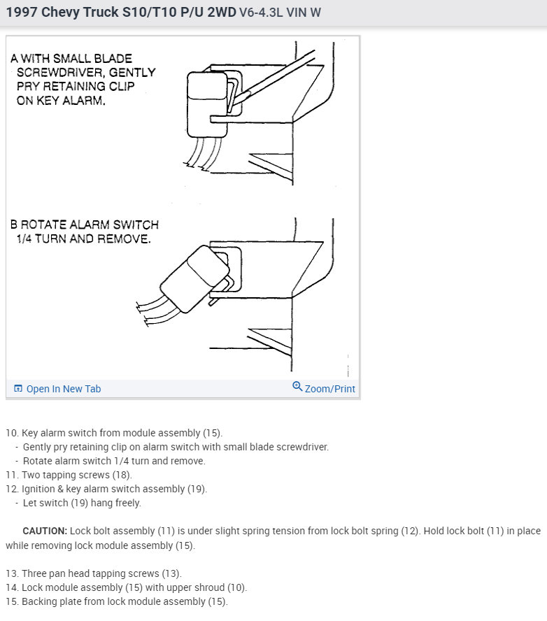

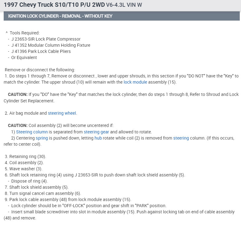

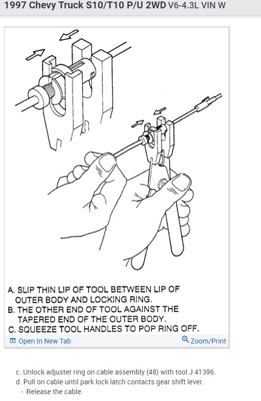

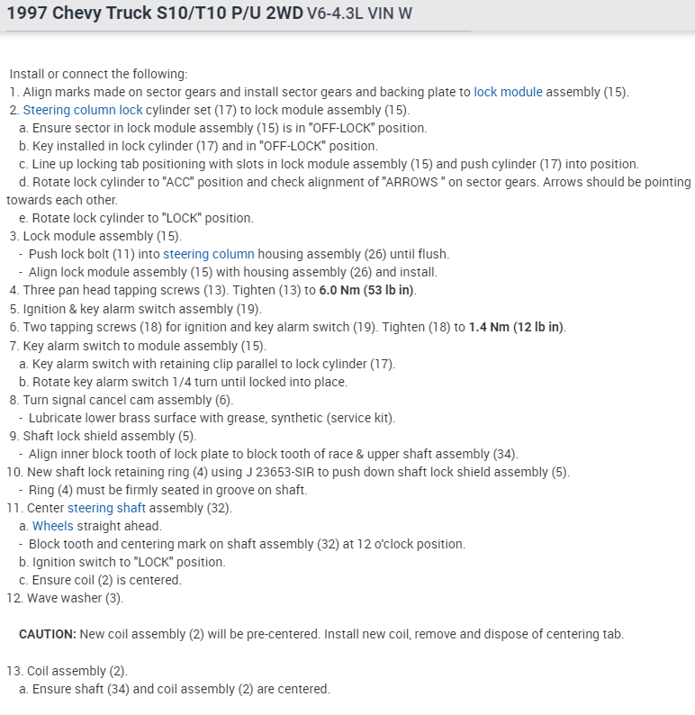

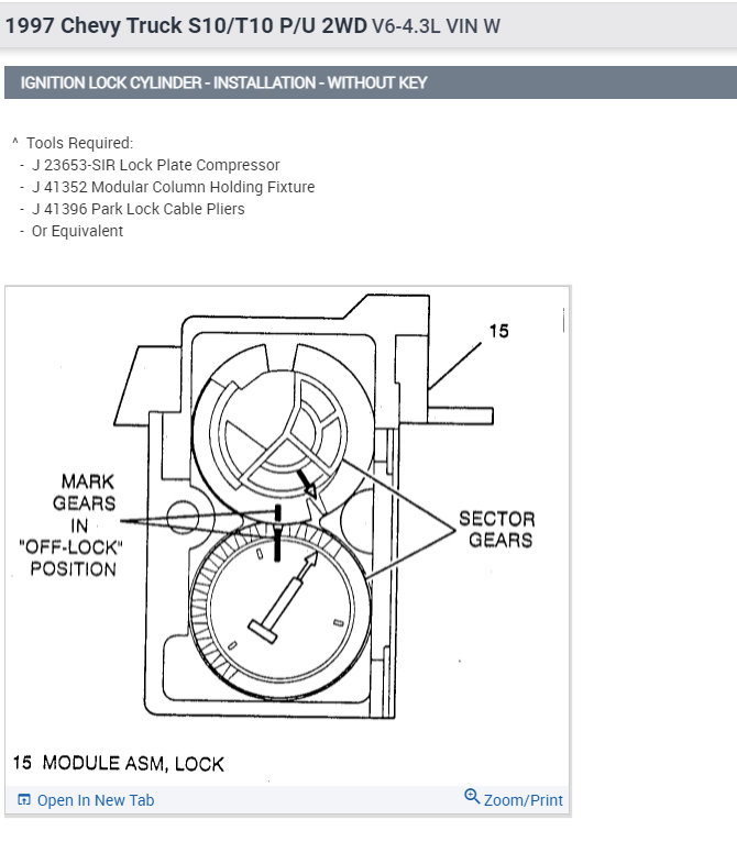

How do I replace the tumbler switch of the ignition on my 97 chevy s 10?
Jul 27, 2008 at 11:01 AM
SQM
  • CAR REPAIR CONTRIBUTOR
  • 6,383 POSTS

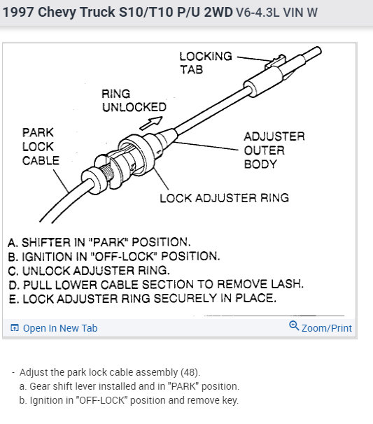

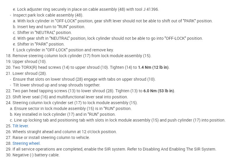

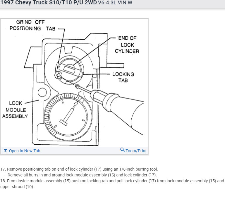

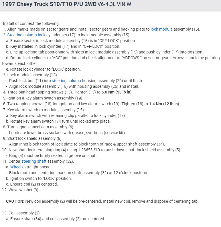

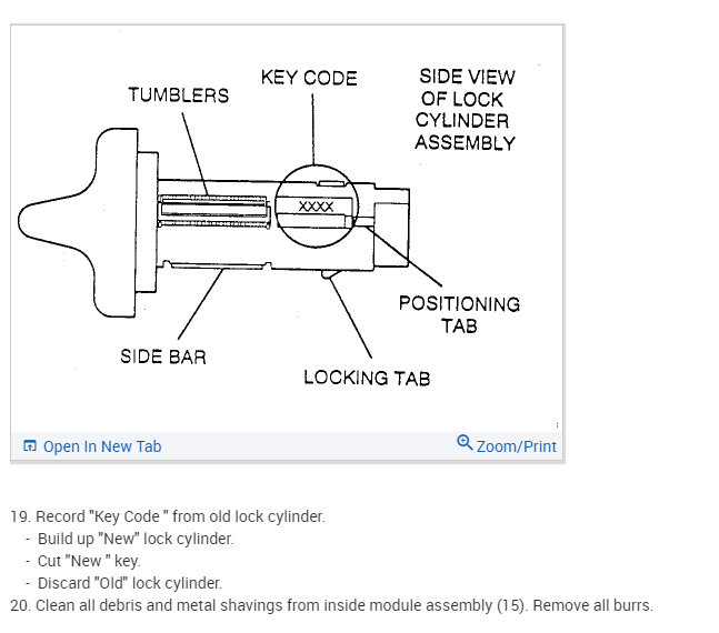

In order to replace the ignition lock cylinder, you will have to remove the steering wheel.
Keep in mind that any time you work around air bag module, take extra precaution. Never point the air bag inflator towards you.
Here is a helpful guide:
https://www.2carpros.com/articles/steering-wheel-removal
