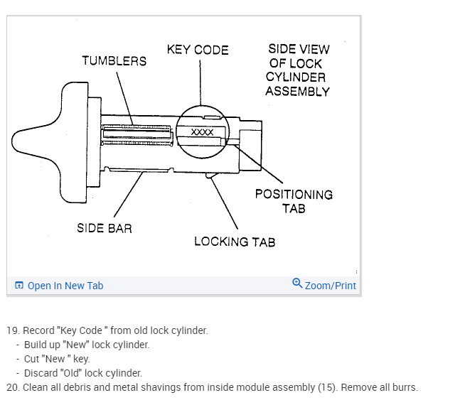

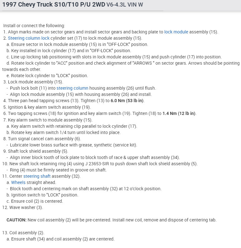

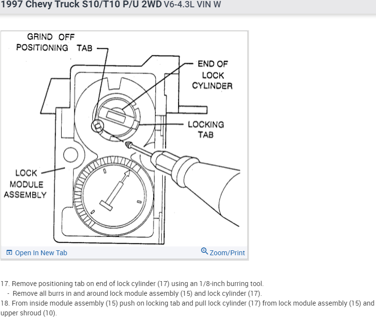

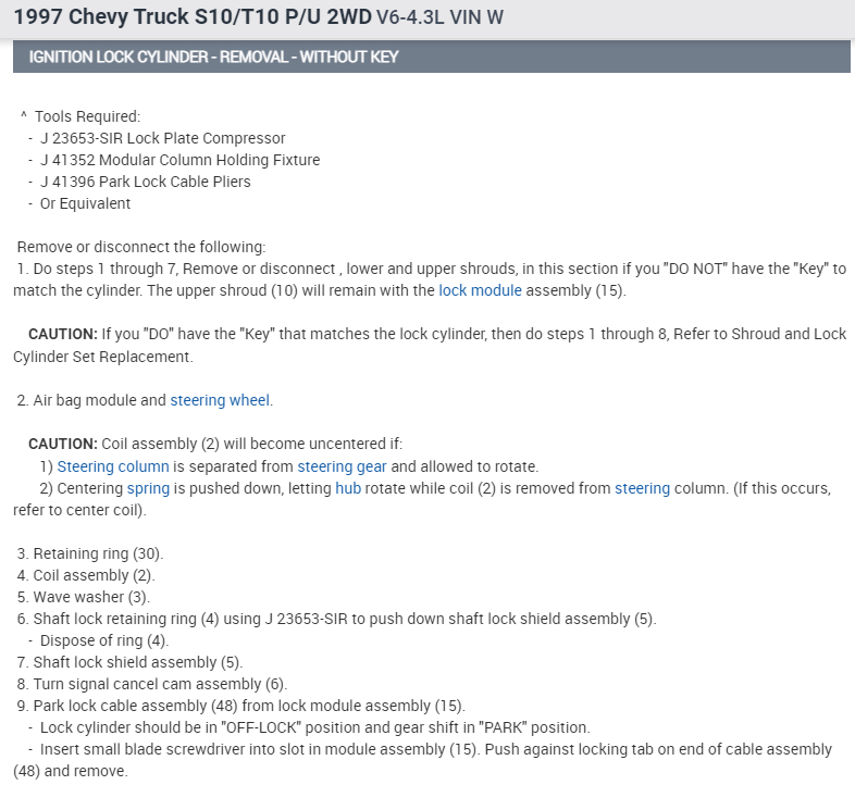

How do I replace the cylinder/tumbler of my ignition?
1997 CHEVROLET S-10
JOE PULY
Apr 21, 2009 at 2:44 AM
SQM
  • 6,383 POSTS

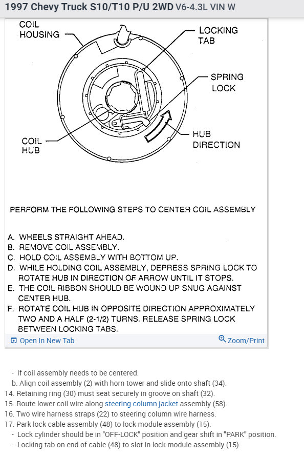

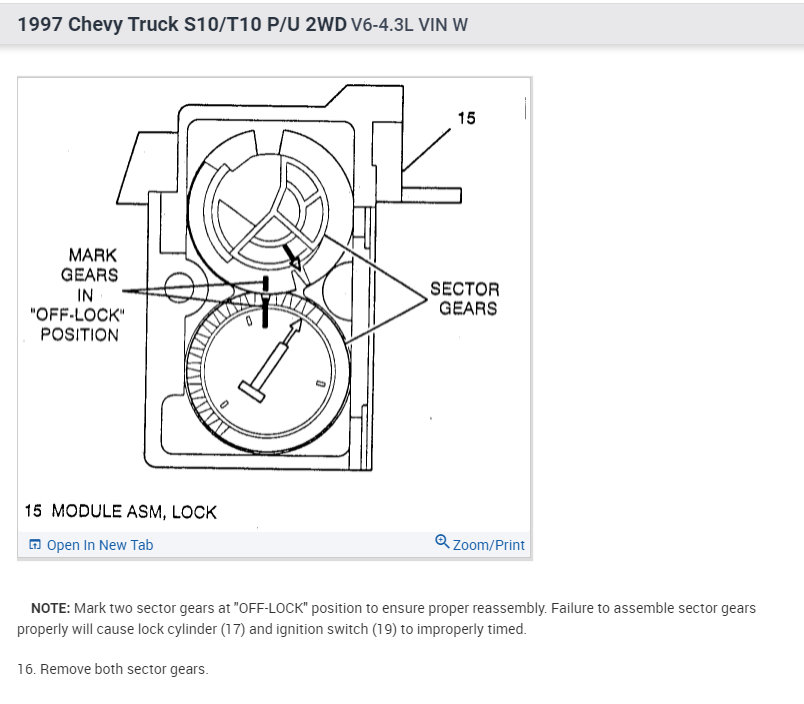

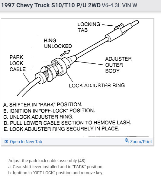

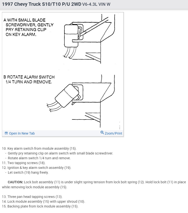

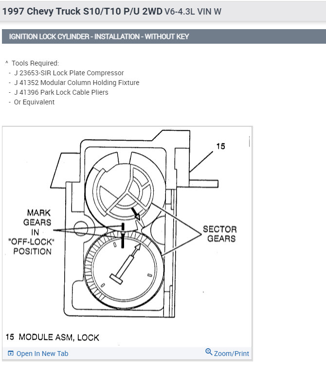

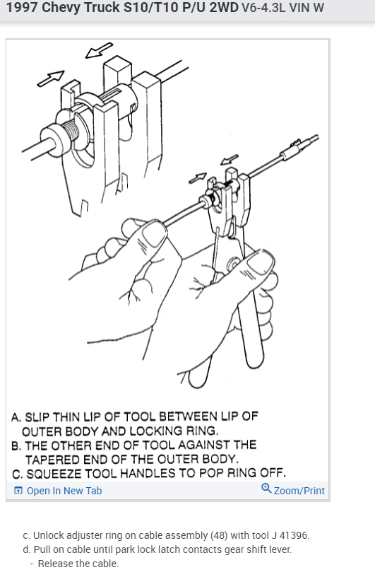

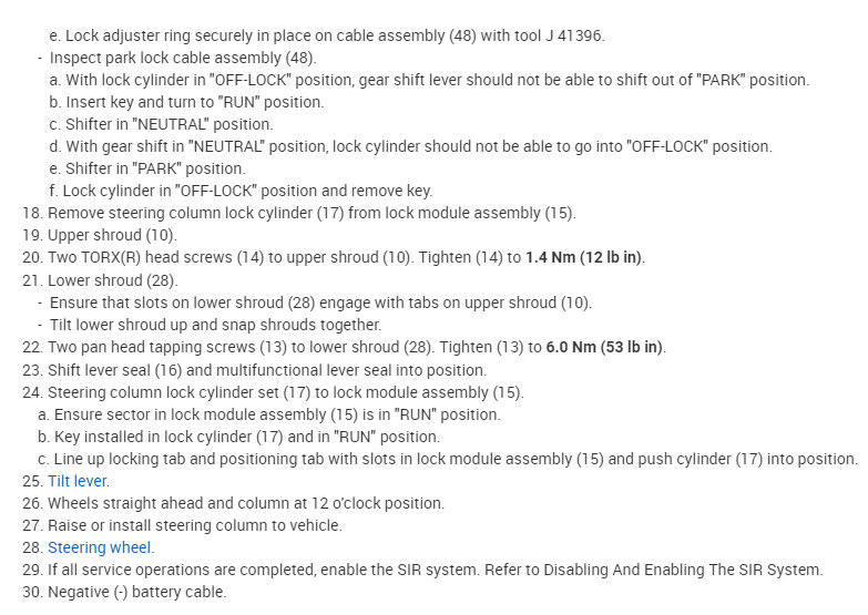

In order to replace the ignition lock cylinder, the steering wheel needs to be removed first.
Take extra precaution when working with the airbag module. Do not point the air bag inflator towards you.
Here is a helpful guide:
https://www.2carpros.com/articles/steering-wheel-removal
