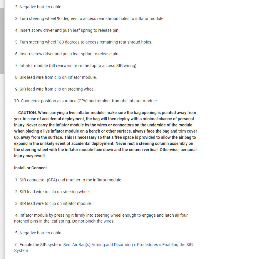

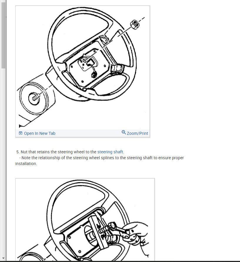

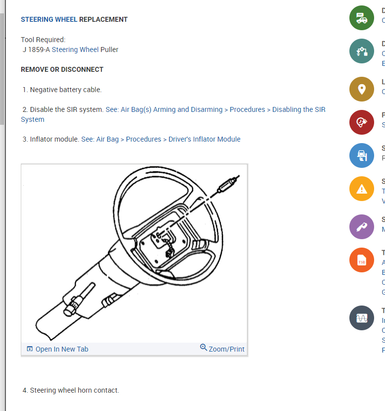

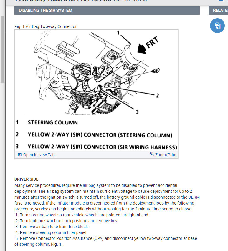

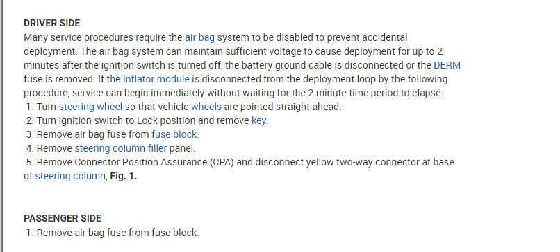

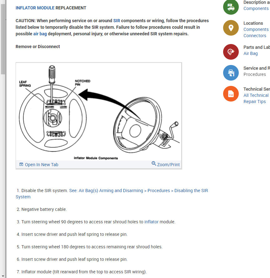

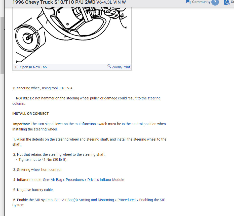

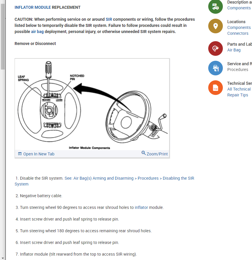

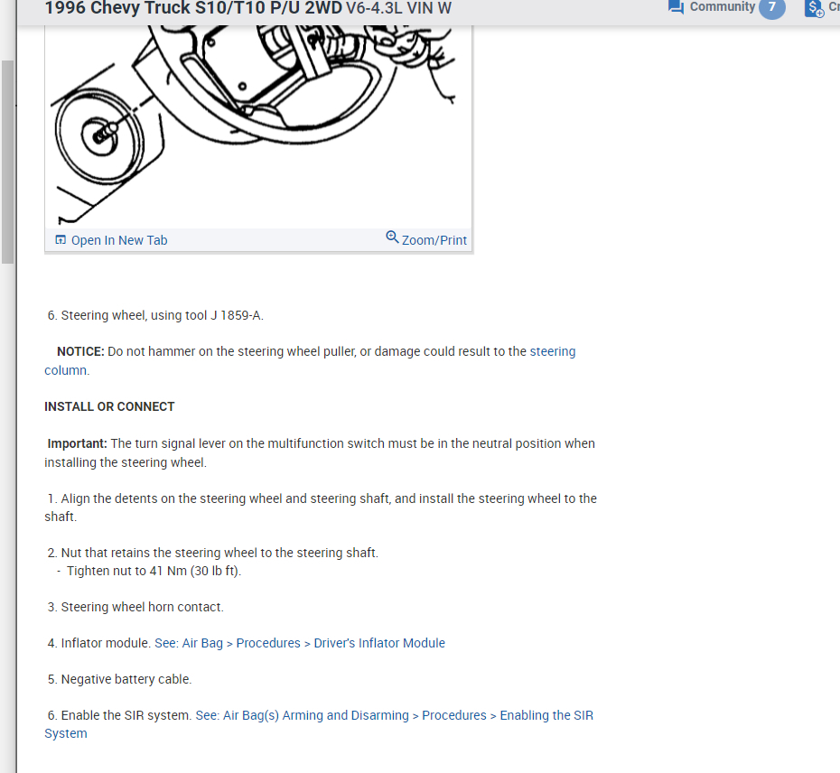

hi im trying to remove the steering wheel and cant figure it out i removed 2 screws in the back of it but i just released the back cover of the steering wheel ,it has air bags so im not sure wut to do
Mar 18, 2009 at 11:54 AM

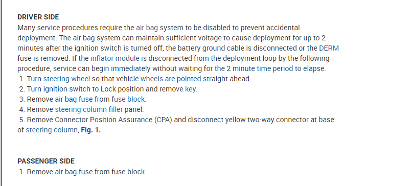

You are going to have to disarm and arm the airbag system, so I am including all the info needed to do this.
Here is a guide that will help with this:
https://www.2carpros.com/articles/steering-wheel-removal
Below is the process on how to do all this including the steering wheel and the airbag system.
Please run through this and let us know what you find with this.
