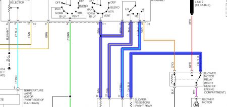

1996 Chevy S-10 6 cyl Four Wheel Drive Automatic 110k miles
opened dash,have 12 volts at fan switch,wonder what to check next. wish i had diagrams,been electrician for 30 years. 4 relays under hood,one for heater? also read something about blower motor resistor under hood? any ideas?tnanks
Dec 26, 2009 at 8:57 AM
  • 75,988 POSTS
Blower Motor Resistor On right rear of engine compartment, on blower module Also you might want to power the purple wire on the blower motor to check if its the motor-
https://images.2carpros.com/forum/automotive_pictures/12900_blower_resstor_1.jpg
