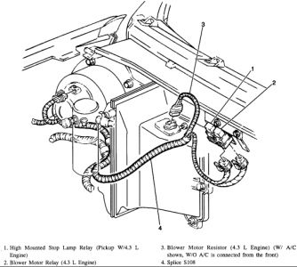

1996 Chevy S-10 6 cyl Automatic 227000 miles
How do you replace the blower motor relay? Is there more than one? My blower ceased working. I have replaced the switch and am trying to replace the relay. Thanks

https://www.2carpros.com/forum/automotive_pictures/170495_blower_relay_1.jpg
There you go. You might want to check your gettng your power and ground to your blower motor first before you start throwing more parts at it.
