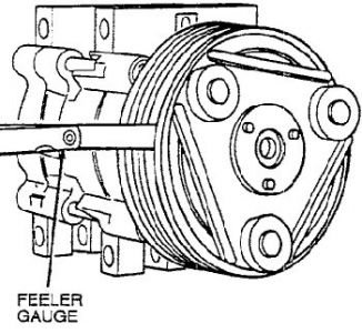

Well, I started the engine with the AC off, then turned the AC on. The engine cut out completely. OK. so I turned the ignition to the off position, turned on the AC, then cranked the engine. It struggled for a second but kept running. I noticed a tiny bit of squeal, but I'm not sure where it was coming from. I didn't notice that the compressor was trying to turn off or anything, it looked like it was running ok. I started to smell the rubber again and noticed a bit of smoke coming out from what I think is the compressor's clutch. I'm not sure if it is actually the clutch smoking or it is the belt that is smoking. I did notice that the clutch area was very hot after running for only 20 seconds or so. Just to make sure I'm talking about the clutch, here's a pic. It was coming out of the right side (closest in the photo).

That is the a/c clutch, but it is probably the bearing that is bad if it is smoking with a/c off.Try removing th ebelt and seing if the hub spins free and smooth, if not the bearing is bad

Just smoking when the AC is on, otherwise there's no problem. What would make it stall when the AC is turned on?
I'll try your suggestion, but I'm thinking it'll spin.

Compressor may be coming apart inside, so it tries to stop the engine when on
