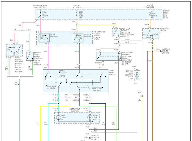

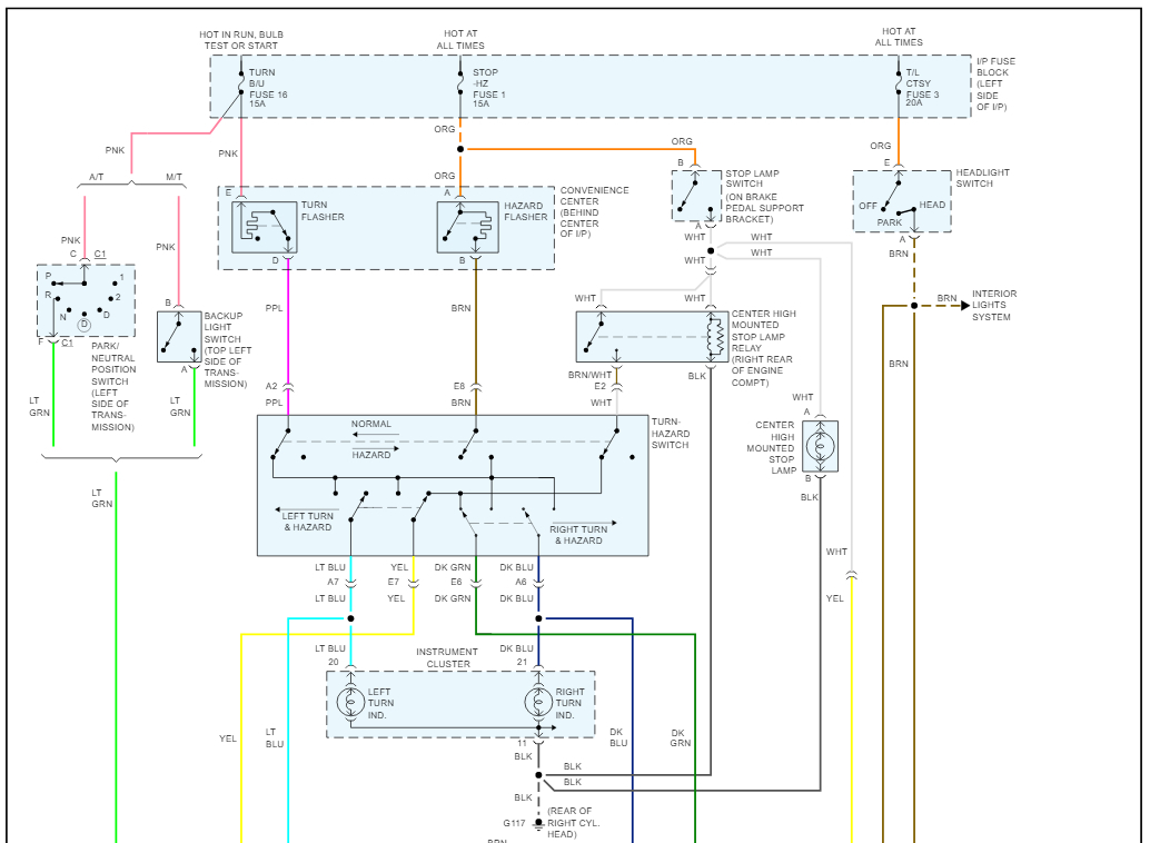

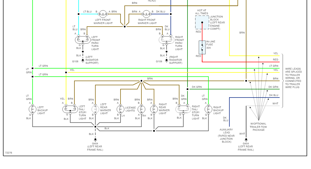

I posted a request for wiring diagram for s10 pick up. the mechanic said he would send me one if i reposted i haven't received an answer. i do need help the new signal switch i cannot get signal lights to work or back brake light the high brake light works.

Sounds like a short in the harness for those lights. I have attached the wiring schematics below.
