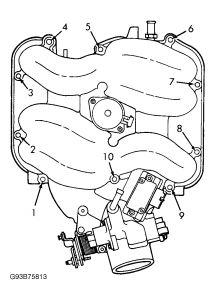

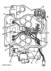

torque specs. for intake manifold bolts ?
Nov 12, 2008 at 6:35 PM
BMRFIXIT
  • 19,053 POSTS
Intake manifold torque spect upper 89 inch lbs lower manifold bolts 35 ft lb
https://images.2carpros.com/forum/automotive_pictures/99387_Graphic1_57.jpg
https://images.2carpros.com/forum/automotive_pictures/99387_Graphic2_33.jpg
