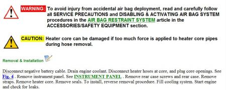

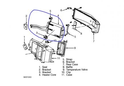

Where is the heater coil on an S-10?
Sunday, July 18th, 2010 AT 9:28 PM
MHPAUTOS
MECHANIC
31,937 POSTS
HI there, see text and pic for heater core location.
