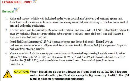

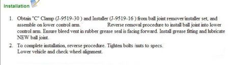

right side lower lball joint replacement, Is it
press in from the top or bottom of the lower
control A arm?
Jun 8, 2009 at 10:31 PM
BLUELIGHTNIN6
  • 16,542 POSTS
Below are the proper replacement procedures..
https://images.2carpros.com/forum/automotive_pictures/261618_Noname_516.jpg
https://images.2carpros.com/forum/automotive_pictures/261618_Noname2_130.jpg
