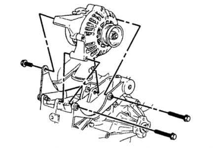

We are trying to remove the alternator we removed both bolts but it doesnt budge. What gives

REMOVAL:
Disconnect the negative battery cable.
Remove the air inlet duct assembly, if necessary.
Carefully relieve the serpentine drive belt tension, then remove the belt from the alternator pulley. Do not allow the tensioner to snap back into position once the belt is off the pulley.
Remove the nut retaining the radiator hose brace to the back on the alternator.
If equipped, unfasten the retainers, then remove the brace from the engine and/or the alternator.
Disconnect the battery terminal boot wiring from the back of the alternator, then unplug the regulator wiring connector.
Support the alternator and remove the mounting bolts (usually 2) from either side of the alternator, then remove the alternator from the vehicle.
https://www.2carpros.com/forum/automotive_pictures/261618_0900c1528024ffad_1.jpg
