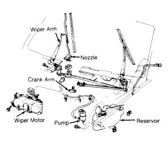

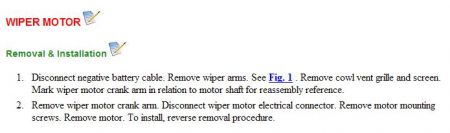

Is it difficult to change the wiper motor in this truck? And could you possibly give me directions? Any help would be GREAT.
Thanks Mike
