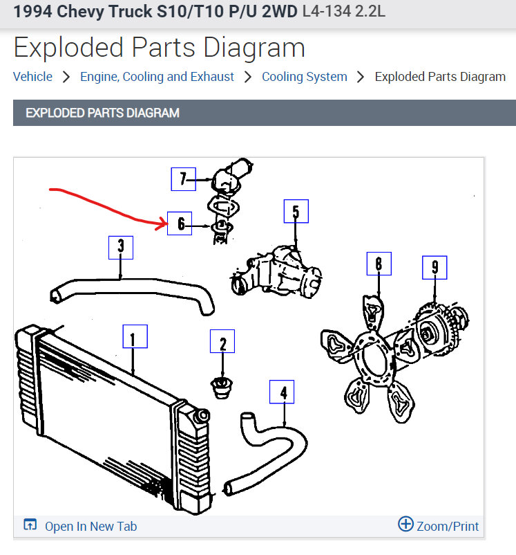

Welcome to the forum, my info gave the picture below.

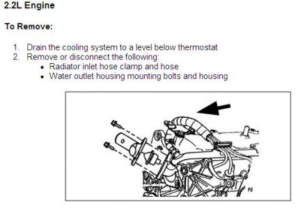

The thermostat is at the end of the top radiator hose. Here is a generic guide to help you step by step with instructions in the diagrams below to show you how on your car.
