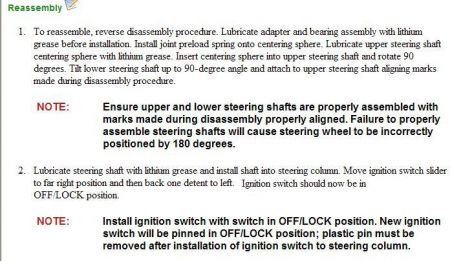

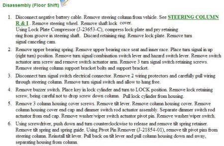

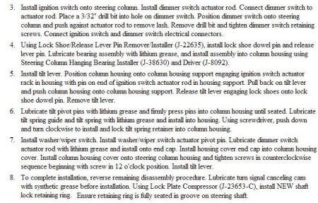

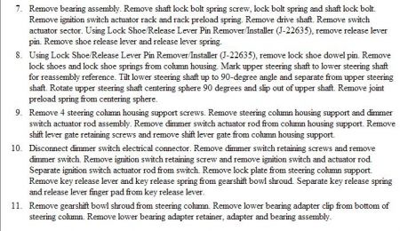

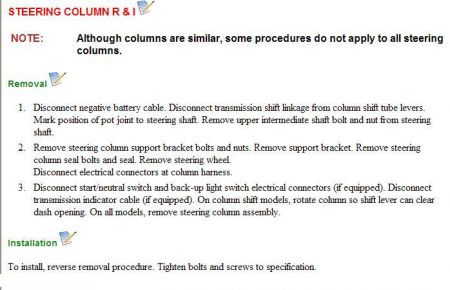

How do I remove the shroud to replace the combonation wiper turn signal cruise control switch

standard or tilt steering column?
Oct 22, 2009 at 2:16 PM
TOMMYBORS
Darn, I thought I had all the info...tilt
Oct 23, 2009 at 10:13 AM
BLUELIGHTNIN6
