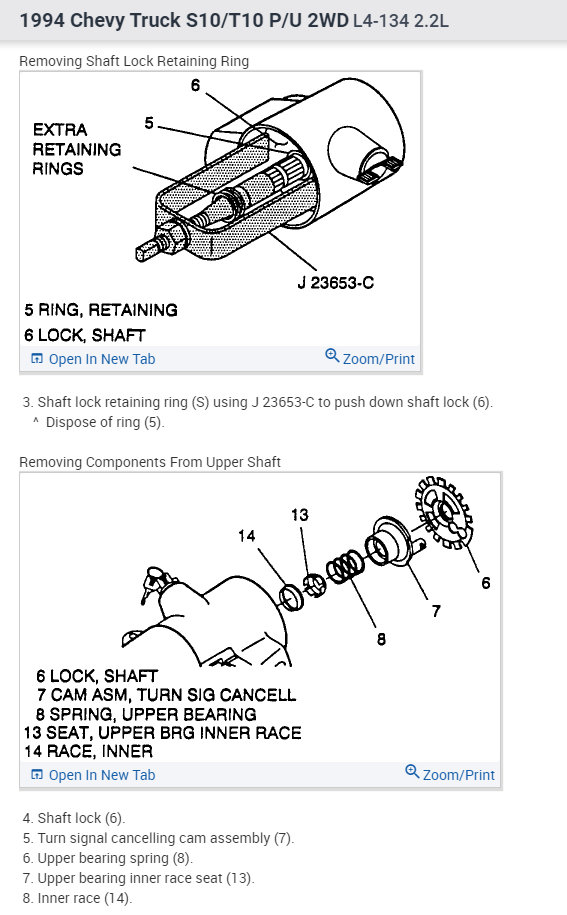

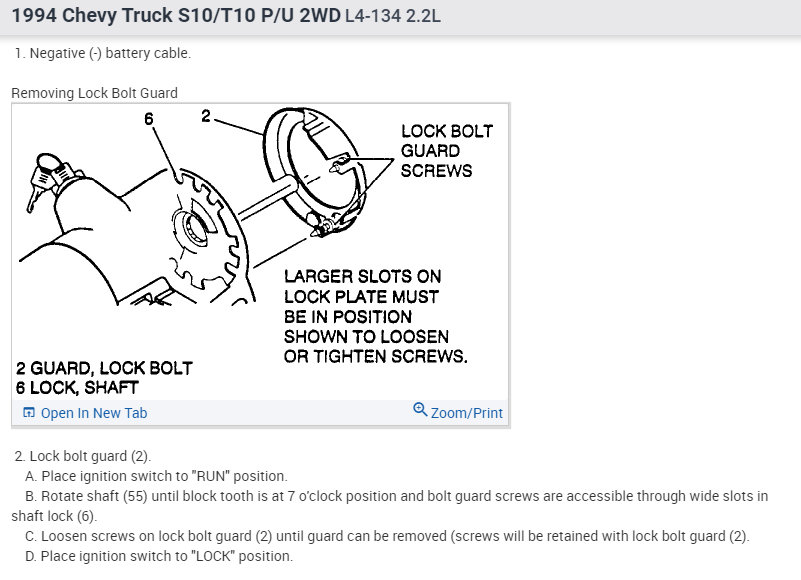

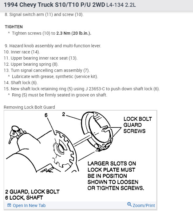

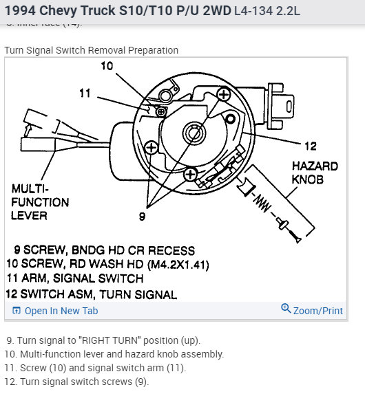

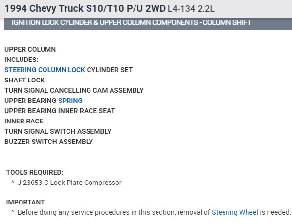

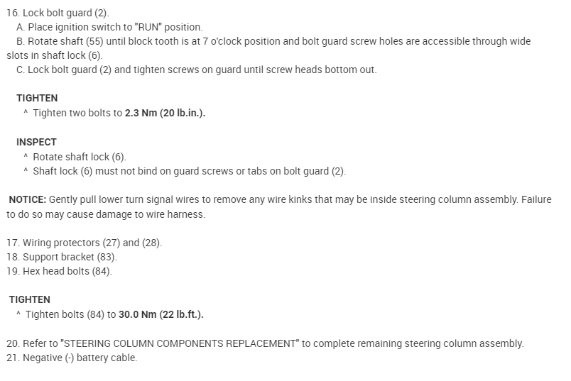

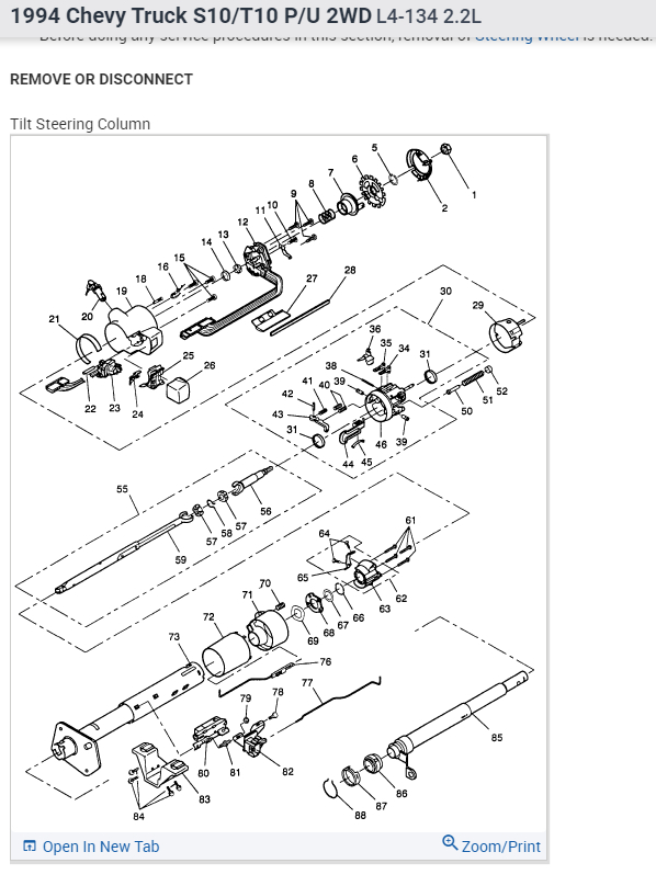

I have a 94 s10 and my ignition switch has gone out and I need to know how to change it can u help me?
Thursday, April 2nd, 2009 AT 4:29 PM
SQM
MECHANIC
6,383 POSTS

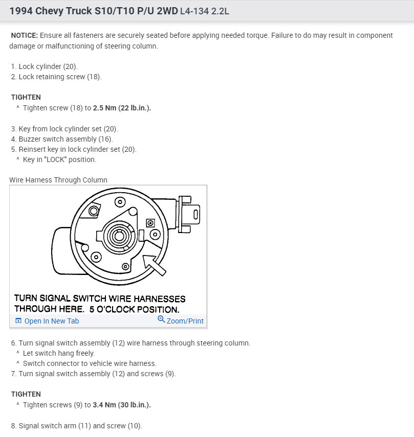

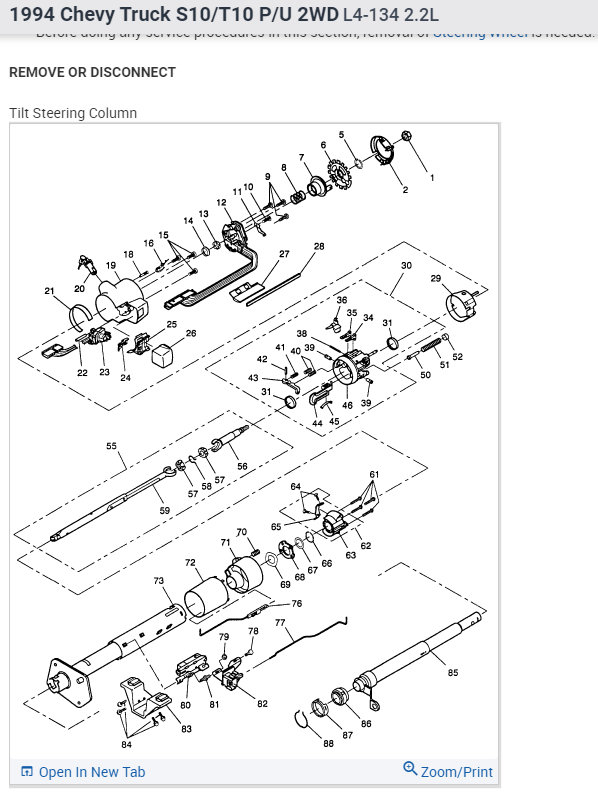

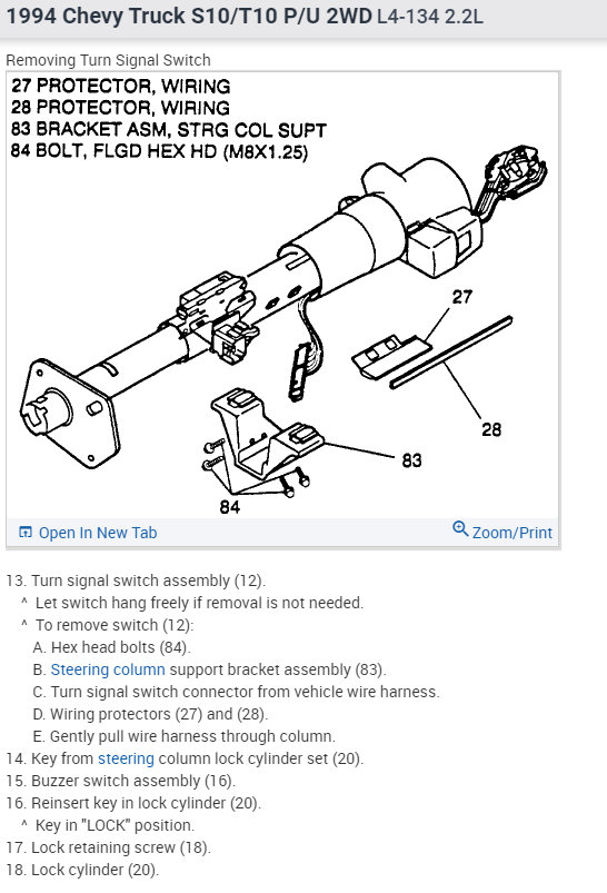

In order to replace the ignition switch, the steering wheel has to be removed first.
Here is a helpful guide:
https://www.2carpros.com/articles/steering-wheel-removal
I have attached the replacement procedure below.
