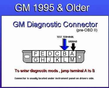

https://images.2carpros.com/forum/automotive_pictures/62217_GM_DLC95_Older_8.jpg
Cross these two terminals as shown, then turn the key on. Count the flashes, a 22 will flash as 2 flashes then a short pause, then 2 flashes, if more than one code is stored, the pause will be longer. The codes will display three times and end with 12. Write them down and post here. This connector is right under the middle of the dash...

who ever had this truck must of cut it out the only plug i can find is under the hood but it is a ten pin sorry what eles can i do i have just chagned the fuel preasure regulator it it still does it my plugs are black and the oil is black can the oil be to full i have high oil pressure it only does this when i start it or when i tap on the pedal to shift iin between it is ok i am lost

Your data link connector is on the left side of the dash to the right of the steering column...

the spark is blue and the data link is not there someone must of cut it out when they put the alarm in it i took out the alarm. i started it this morning it was fine then i shut it off waited and started it again and then it started doing it againblack smoke when i hit the gas and if i hold it it goes away

We need to find out where that DLC went! See if they un screwed it and tucked it up someplace...See if you can find a white/black and orange wire together.

there is no wire like that under the dash i pulled the hole dash out the only plug that would look likr that is under the hood but it is a pin it say (p.e.d.4) on the cover and the pins are lettered a through k i tried the a ans b pins but no codes do you think it could be the cam postion sensor there it a plug that goes from lower passehger side block to the coil packs
