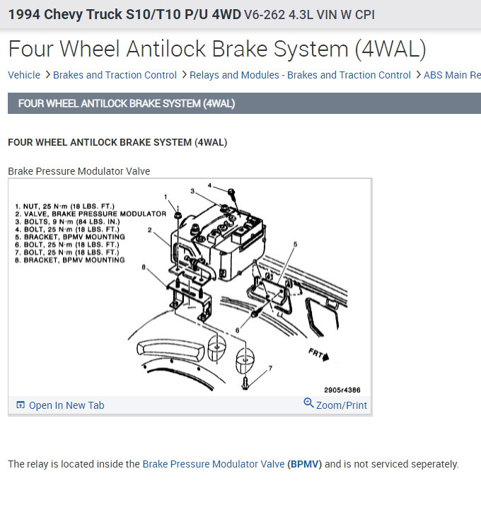

I have replaced all the wheel speed sensors,but the light still comes on the brakes feel normal .I tried unhooking the battery for a few minutes before I started it,but the light still came on.Any suggestions
Sep 11, 2008 at 8:28 AM
SQM
  • 6,383 POSTS

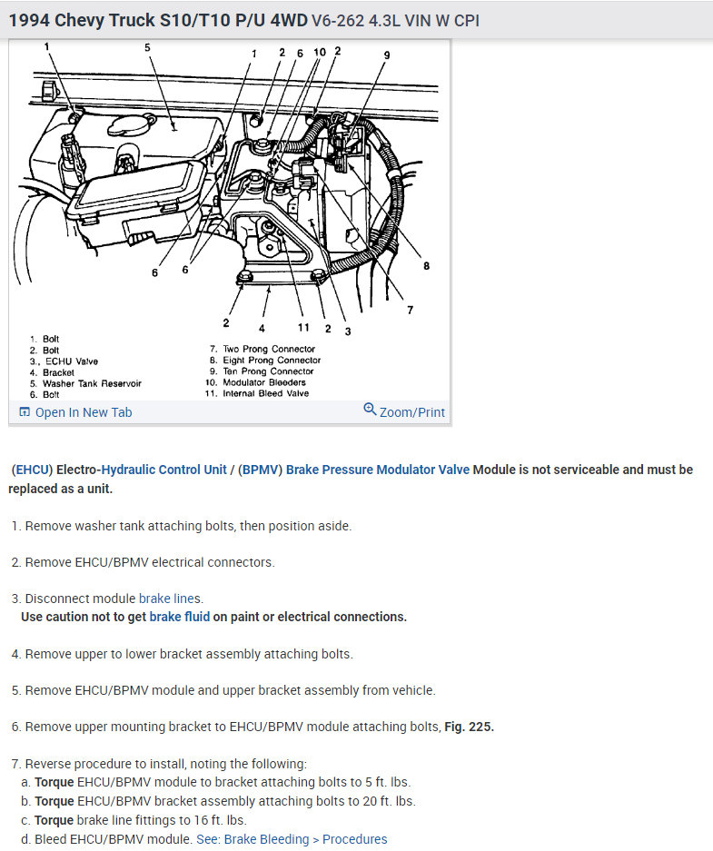

This could be an issue with the ABS module.
First step would be to get the ABS light scanned for trouble codes. It can point to the right direction of what might be the issue with the system.
This can also be due to a faulty relay. The ABS relay is located under the hood, it is located in the ABS module by the master cylinder.
