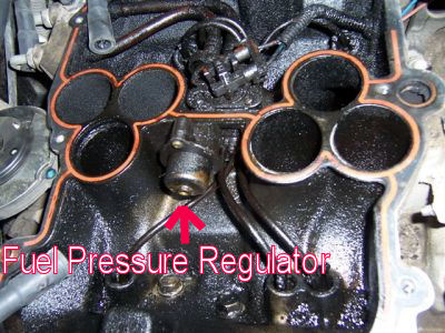

OBXAUTOMEDIC
  • 3,711 POSTS
Have you checked the fuel pressure and the fuel regulator?
Here's a video on how to test....
https://www.2carpros.com/car_repair_video/test_fuel_injection_pressure.htm
Saturday, July 5th, 2008 AT 7:27 PM
BIGBLUE
  • 8 POSTS
Were is the test port and the pressure regulater located?
What is the correct pressure for my blazer
-1
Sunday, July 6th, 2008 AT 7:41 AM
OBXAUTOMEDIC
  • 3,711 POSTS
The test port is on the left rear of the intake.
Fuel Pressure:
4.3 Vin W (8TH DIGIT OF VIN) - 55- 61 PSI
4.3 Vin Z Torbo - 38 - 43
Here is a pic of were the Regulator is....
https://www.2carpros.com/forum/automotive_pictures/188069_53070_95cfi_1_1.jpg
You will have to remove the Plenum to get to it.
