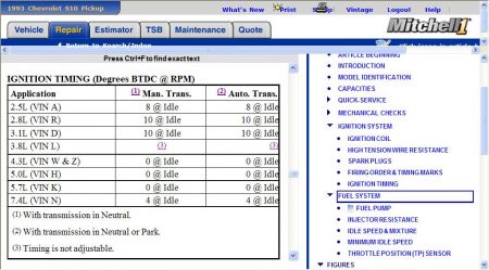

What is the timing on the 4.3 motor with a throttle body.

what is the timing on the 4.3 motor with a throttle body. The timing should be 0 deg/TDC at idle

I had already purched a Chilton, It tells me to look under hood, There is nothing there. Thanks very much, rusty
