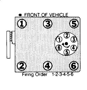

I just acquired a trike (3 wheeled motorcycle) custom built from the running gear of a 1992 Chev S-10 2.8L V6 with 4 speed manual transmission. I can't find the tune-up specs (points, spark plug, and timing) settings anywhere.
Can you give me the tune-up specs and part numbers?

Spark plug: AC Delco R43TSK. Gap 0.45" Spark plug wire: Borg Warner CH7653 Distributor cap: Borg Warner C218 Distributor rotor: Borg Warner D189 Air filter: Fram CA3588 Fuel filter: Fram G3727 PCV valve: Fram FV191 Firing order:

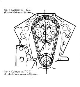

Ignition timing: 10 degrees BTDC @ idle @ Neutral. Procedure: 1. Set parking brake, block drive wheels and place transmission in Neutral. Warm engine to normal operating temperature. Turn A/C off (if equipped). Ensure SERVICE ENGINE SOON light is off. 2. Disconnect Tan/Black Electronic Spark Timing (EST) by-pass connector wire, located near heater housing in passenger compartment. On all models, DO NOT disconnect 4-wire connector at distributor. 3. Connect timing light to No. 1 spark plug wire. Check timing and adjust if necessary. Reconnect EST by-pass connector, and clear ECM trouble code. Ignition coil resistance: 500 - 1500 ohms Idle speed: 800 rpm Just in case you need it. Timing marks:
