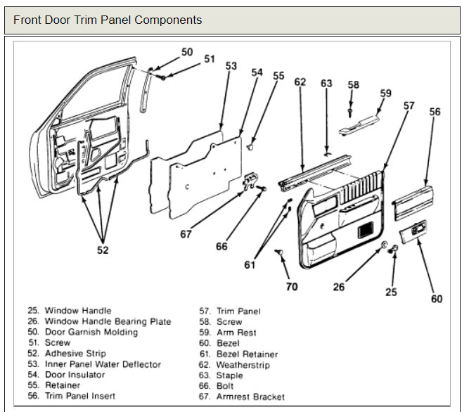

You will need to remove the door panel first. this guide will give you an idea of what to do:
https://www.2carpros.com/articles/door-panel-removal

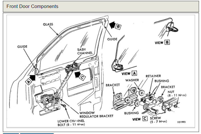

This guide will show you how to get the door glass out:
https://www.2carpros.com/articles/how-to-check-and-replace-a-electric-power-window-motor

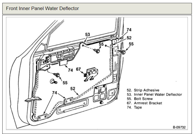

The water deflector is secured by a strip of adhesive between the deflector and door, as well as waterproof sealing tape. Upon installation, make sure a good seal is achieved to keep water from entering into the body. If necessary, use strip caulking as a sealant between the deflector and door.
Lower the window until it and the sash channel can be seen in the door panel opening, then remove the sash assembly-to-window bolts. Remove the sash assembly and the window from the door.
On some late model vehicles it may be necessary to remove the sash assembly, then cut the clips from the glass in order to remove the glass from the door. If this is done, new clips must be installed on the glass before it is lowered into the door and rotated into the run channel.

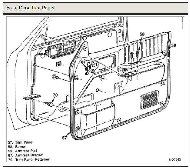

There are two phillips screws in the door handle coming down from the top. Remove them and slide the door handle rearward to lift it out. Now starting at the bottom of the door take a screwdriver and pick a spot between the door panel and the inner door to put pressure on. Where ever the panel won’t come away from the inner door is where the lock buttons are. Insert the panel button removal tool where the panel is tight and pry to pull the button. Repeat all across the bottom and up the sides. There is one last button behind the plastic by the mirror. When you get it loose, wiggle and lift the panel up and away from the window.
Now lower the window about 1/3 of the way down till you see the two 10mm bolts going through the glass and the regulator channel. Wedge either a wood or plastic wedge in between the inner door metal and glass to hold the glass in place. Remove the bolts, regulator channel, and plastic mount from the bottom of the glass.
Now let the window go to the bottom of the channel. Rotate the window from the back towards the front (counter clockwise rotation) and when the window clears the channel lift it out of the door.
To reinstall reverse the removal procedure. Insert window in door and rotate counter clockwise into both channels. You should now be able to raise the window by hand, in the channel, and put a wood wedge to pinch the window so it won’t fall. Now you can put the regulator bracket bolts, plastic and guide in place and secure.
When you put the bolts and regulator guide on the window make sure your plastic, the regulator guide, and bolts are all lined up through the window. Use blue loctite to hold the bolts. Snug the bolts enough to hold the window. Do not overtighten or you could break the glass. The loctite will hold the bolts. There isn’t any torque spec that I could find. I tightened mine with a 1/4" nut driver with 10mm socket. Not as tight as I could get it just snug. Be sure the regulator lever is installed in the regulator channel before you snug the bolts. Now remove your wedges, hook up you window switch and power the window up and down to make sure it moves freely.
If all is good install your inner panel, inserting the top edge in first and down far enough so your panel buttons line up with the holes they are supposed to go in. Work your way around the door starting at the sides and gently push the door panel in a little at a time. When all buttons are started go around and press them in till the panel is tight against the inner metal. You are done!
