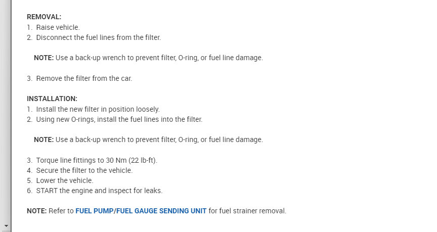

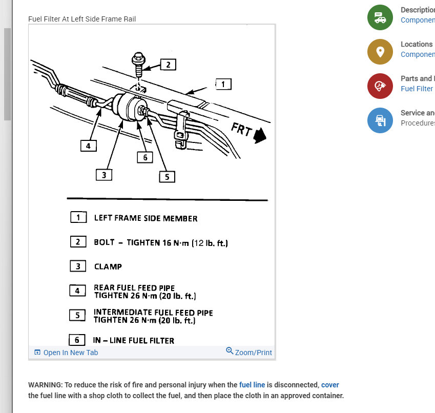

where is the fuel filter?
Mar 4, 2008 at 4:22 AM
The filter is on the frame rail and held in place by a bolt.
I am attaching the process from the manual below but here is a video on a little newer S10 that will help with this:
https://youtu.be/3RGTP2XUgp8
Please see the info attached and let me know if you have other questions.
