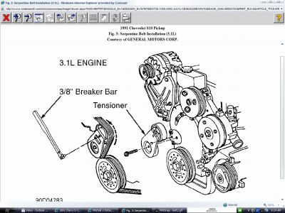

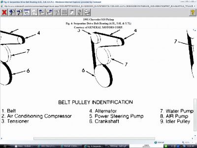

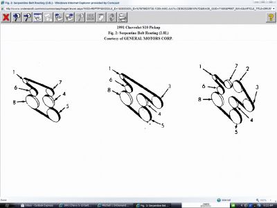

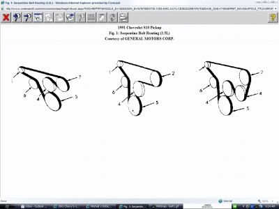

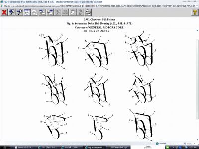

1991 Chevy S-10 V6 Two Wheel Drive Automatic 110000 miles
need belt routing diagram with and without air condioning

Here ya go!
