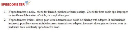

I have a Chevy S-10 truck its a manual. My speedometer is not working. Where should I start looking at first and if thats not the problem where should I look at next.

https://www.2carpros.com/forum/automotive_pictures/261618_Noname_992.jpg

My speedometer needle is not moving

Your speedo cable most likely broke. Will need to remove cluster and see if cable is still attached properly.
