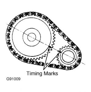

Dose the timing have to be dead on, or can it be off alittle bit and still start.
Wednesday, December 31st, 2008 AT 6:06 PM
BMRFIXIT
  • 19,053 POSTS
The timing has to be on
https://www.2carpros.com/forum/automotive_pictures/99387_Graphic1_142.jpg
Wednesday, December 31st, 2008 AT 7:02 PM

The destribiter, dose it have to be dead on at tdc.
Thursday, January 1st, 2009 AT 8:29 AM
BMRFIXIT
  • 19,053 POSTS
As a helper cranking the engine u can turn the distributor left and right a bit
see if that help
if the distributor of a bit it should try to start but if a lot no
Thursday, January 1st, 2009 AT 11:01 AM

What should I do if that don't start the truck
should I take the destribiter out and try retiming it
Thursday, January 1st, 2009 AT 11:10 AM
BMRFIXIT
  • 19,053 POSTS
I wouldn't take the distributor out just for trying
rotating the distributor left and right should compensate for any timing of if any
if not then you are looking in the wrong area
and or timing chain is out of timing
