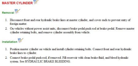

How do I go about changing the master cylinder

https://images.2carpros.com/forum/automotive_pictures/261618_Noname_1305.jpg
https://images.2carpros.com/forum/automotive_pictures/261618_Noname2_391.jpg
