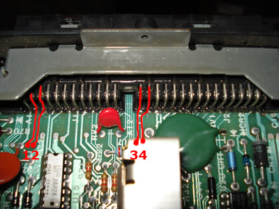

I own a 1986 Chevy S-10 Blazer. I keep burning up a component inside my ECM. My truck runs fine until the ECM burns up, usually after a day after installation. Then the truck misses throughout the speed range, and backfires occasionally. After the ECM burns up, I check my timing and the timing is way off. Resetting the timing fixes the backfire problem but it continues to miss random cylinders. I have new spark plugs and wires and a relatively new distributer. I have uploaded a picture to show which chip is burning up, in hopes that somebody has the schematics to determine what this chip controls. Something has got to be shorting out somewhere. [img:8c4ab2f695]http://www.2carpros.com/forum/automotive_pictures/136989_DSC00508_copy_small_1.jpg[/img:8c4ab2f695]
If you need a larger, more detailed picture, I have them available to email. If you need any other info, I'll give it to you. Im at the end of my rope here. Any ideas?

Hello !! Well It`s going to be hard to find an schematic for the ECM but i have a suggestion: follow the circuit board lines that leads to the chip and see the color codes on the connector, that way I can get you an a wiring schematic and with the color of the wires we will know what sensor/actuator or device its feeding... what do you think? let me know!! Good luck! BTW Thanks a Lot for your donation! I`ll be in contact!

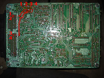

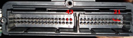

Ok, I looked at the bottom of the board. Most of the leads go to other chips, all of which look fine. There are four leads that run to the electrical connectors. I have uploaded pictures of my trace and have labeled everything.
https://images.2carpros.com/forum/automotive_pictures/136989_DSC00511_copy_1.jpg
https://images.2carpros.com/forum/automotive_pictures/136989_DSC00515_copy_1.jpg
https://images.2carpros.com/forum/automotive_pictures/136989_DSC00516_copy_1.jpg
Wire 1 leads to Connection A2 which runs into a brown wire Wire 2 leads to Connection A3 which runs into an empty socket Wire 3 leads to Connection C1 which runs into a black wire with a purple stripe Wire 4 leads to Connection C2 which runs into an empty socket.\

Well I was checking the diagram and by the connexion number (the color is different) the A1 Dark green-white (the brown on yours) feeds the fuel pump relay...
And the C1 black-Pink feeds the air control solenoid...
What do you think?
let me know if you find the same codes..
Jan 4, 2008 at 10:40 AM
REALAMERICAN
Lets see, Mines A2, not A1. A2 is connected to the air conditioner relay. i dont know if it could burn out the ECM but I did have A/C problems. There was no current to the A/c relay before. I will have to check the wires on this to check for a cross. As for C1, where is the air control solenoid located? C2 says it goes to the 'air sw sol' what solenoid is this? and why doesnt my ECM plug have a wire for it?
