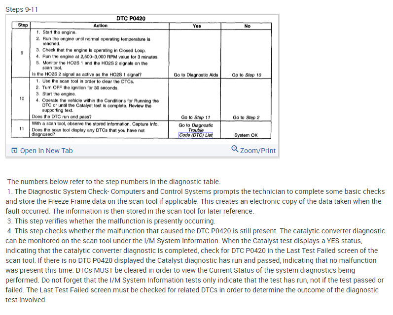

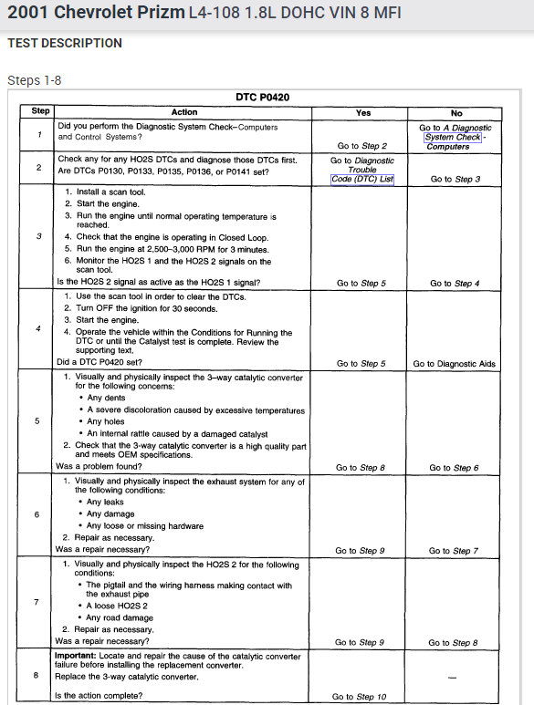

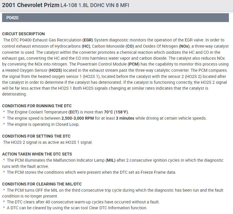

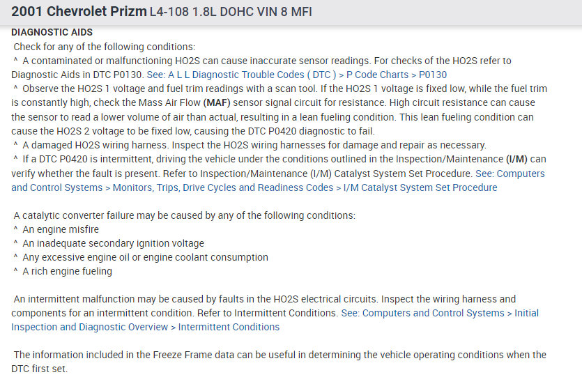

The P0420 code is for the catalytic efficiency below threshold. It can be due several factors. This code can also be triggered due to the engine running rich. Which can be a issue with the oxygen sensor.
I have attached the diagnostics for the code P0420. Go through that step by step process and you should be able to pin point the issue.
https://www.2carpros.com/trouble_codes/obd2/p0400
