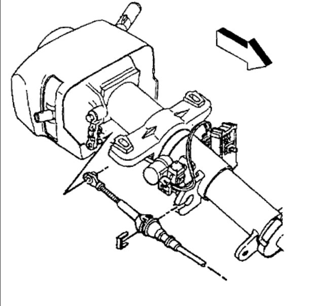

1998 S10 pickup two wheel drive with a four cylinder engine automatic 88,000 miles. Truck will not set in park and will only start in neutral.The problem just started all of a sudden, I stopped for gas truck was fine got back in and went to crank and it would not crank. When you put the truck in park, the P in the dash does not light up and the truck will roll and you do not have to press the brake to move the gear shifter. I have to put the truck in neutral to crank it.
Aug 7, 2006 at 8:52 AM
MIKEYBDMAN
  • 623 POSTS

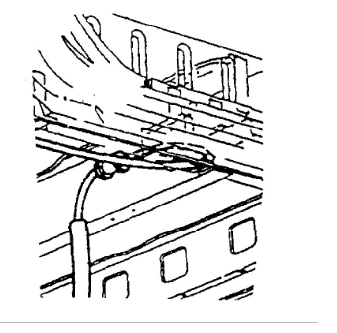

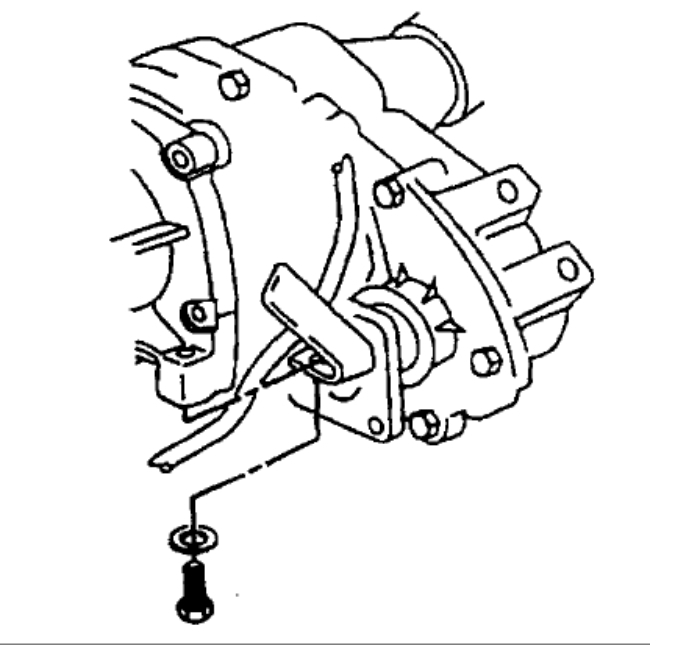

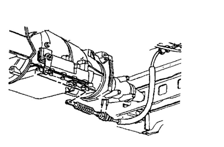

It sounds like the shift cable is coming apart and not able to fully shift the transmission into park. Here is a diagram of the shift cable so you can check it out. (below) you will need to raise the car up safely:

You guys nailed it! I replaced the cable and the truck works perfect. I love this site. :)

I would try adjusting the cable. The transmission is the only part that allows the transmission to go into park, if the linkage is not adjusted properly (to tight of tolerances) then it cannot travel into park. Put the truck in neutral with e-brake on. Is the needle on the dash in the center of the "N"? If it is not, then you have to crawl under the vehicle, and loosen a nut on the linkage. That is the adjustment side. Put the vehicle into park if you can with the nut loose and the shifter in park. When both are in park, then tighten the jamb nut and then try to shift normally. If works, great, if not, go to transmission shop. This is a GM product and I rarely see any issues with this type of vehicle.

The best way to tell is to disconnect the shaft cable from the transmission (parking brake on) and see if the if you can put it in park, this will help you see if it is the cable/shifter or the transmission.
