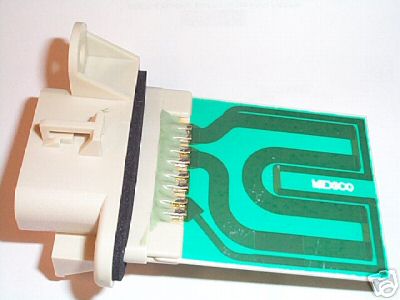

2001 Cheverolet Cavalier with 136,000 on 2.4L engine. The blower motor for the heat/AC is starting to go out. First the motor would not run/blow on the lowest setting. Now the medium-low setting does not run. The motor runs fine on medium-high and high. Any ideas? A guy at a dealership mentioned a resistor. If so, is it a pain to repair myself or is it better to have professionals do the work?

It shouldnt be too hard to replace, just remove screws unplug it, and replace it. This part should be situated under the hood by the blower fan motor.
https://images.2carpros.com/forum/automotive_pictures/13857_1f3a_1_1.jpg
here is a pic of what it should look like hope this helps
