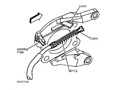

SERVICE WRITER
  • 9,123 POSTS
https://images.2carpros.com/forum/automotive_pictures/30961_lever_1.jpg
This is the area you need to access. It is where the parking brake is attached to the caliper. You should have disc brakes.

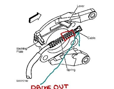

SERVICE WRITER
  • 9,123 POSTS
https://images.2carpros.com/forum/automotive_pictures/30961_lever_2.jpg
The spring on one or both side will be scrundched up to the red area. The blue arrow show the lever you need to drive forward. Take a small/medium hammer, a couple flathead screw drivers of different sizes, or punches....but no clubs. and a blanket to lay on.
