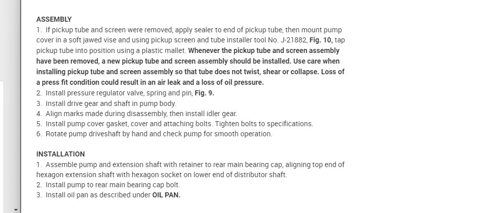

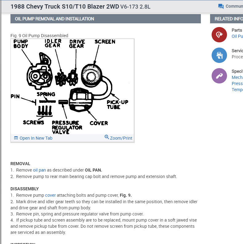

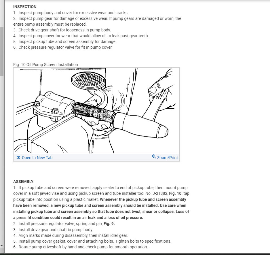

1988 Chevy S10 v6 2.8
How do you replace the oil pump? Can this be done without removing the engine? I have basic+ car mechanical skills.Thanks in advance.
Dec 5, 2006 at 12:57 AM
I am attaching the info from the manual on how to replace this.
Also, here is a guide that will help with low oil pressure issues in case you need this:
https://www.2carpros.com/articles/high-or-low-engine-oil-pressure
Please run through this and let me know what questions you have. Please see the info attached below. Thanks
