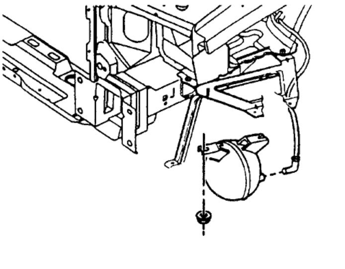

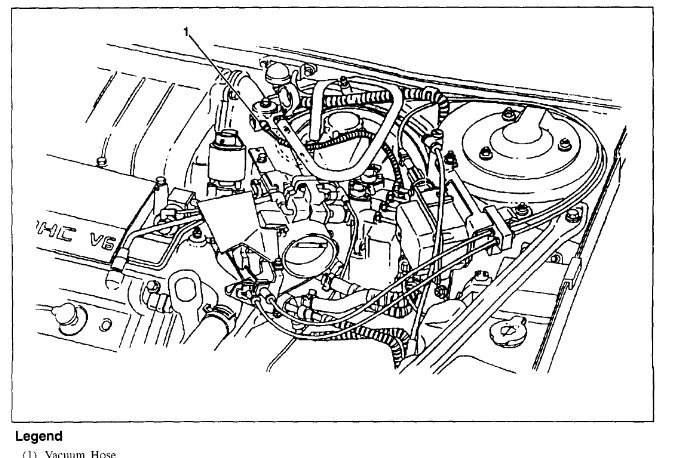

BSHERWOOD
I was able to locate what I think is a vacuum line that was disconnected. It is on the inside of the front drivers side fender, under the hood, behind the battery. One end of the hose is connected to a T shaped connector, and the other is just hanging loose once I connected it the system started working.

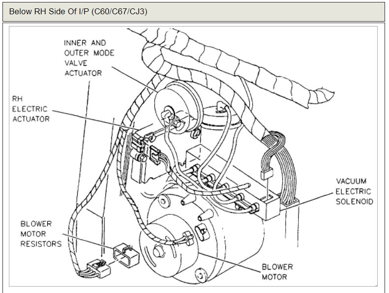

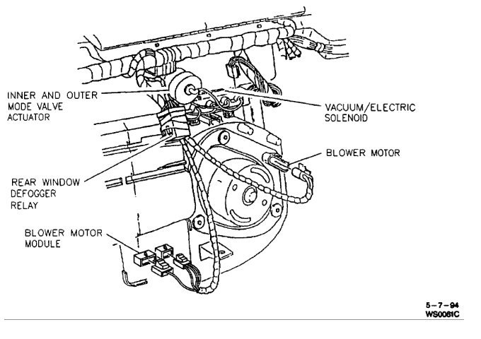

Hey Guys,
Here is a vacuum diagram and vacuum storage tank so you can get the problem fixed. Also a guide so you can follow and test the hoses. Also there is a rotary vacuum valve in the dash that goes, bad, can you hear a vacuum leak just behind the climate control panel?
