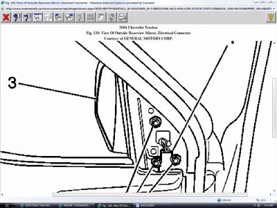

So some yahoo broke the side view mirror off the passenger side of my 2004 Tracker. I bought a replacement part from ThePartsBin. Com after they assured me it was easy to install and came with instructions. Received the part, NO INSTRUCTIONS. Grrr. Called ThePartsBin. Com and basically they said i'm sol.
it isn't a power mirror, doesn't have electronics attached to it. Should be simple to install. I'm a car repair virgin.
how do I get this thing on my car?
help please.
Friday, August 8th, 2008 AT 3:55 PM
MERLIN2021
  • 17,250 POSTS
Remove the door panel, remove the three bolts and mirror, install is the reverse!

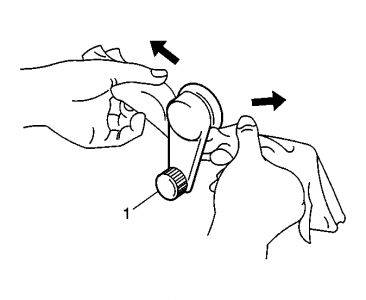

TRIM PANEL REPLACEMENT - SIDE REAR DOOR Removal Procedure 1. Remove the rear side door inside handle (1). Refer to Door Handle Replacement - Rear Inside . 2. Remove the screw which secures the rear side door pull handle (3). Fig. 27: View Of Rear Side Door Components Courtesy of GENERAL MOTORS CORP. 3. Use a cloth in order to pull off the snap ring which secures the rear side door window regulator handle (1), if equipped. 4. Remove the window regulator handle (1), if equipped. Fig. 28: View Of Window Regulator Handle Courtesy of GENERAL MOTORS CORP. 5. Gently pry the rear side door trim panel (2) from the rear side door by disengaging the plastic retainers which secure the panel. 6. Position the door trim panel (2) away from the door in order to gain access to the rear side window switch electrical connector, if equipped. 7. Disconnect the window switch electrical connector, if equipped. 8. Remove the door trim panel (2) from the vehicle. 9. Remove the rear side window switch from the door trim panel (2) by releasing the 4 plastic retaining tabs, as needed. Fig. 29: View Of Rear Side Door Components Courtesy of GENERAL MOTORS CORP. Installation Procedure 1. Install the rear side window switch to the rear side door trim panel (2), if removed. Ensure that the 4 plastic retaining tabs are fully engaged. 2. Connect the rear side window switch electrical connector, if equipped. 3. Install the door trim panel (2) to the rear side door. Ensure that the plastic retainers are fully engaged. Fig. 30: View Of Rear Side Door Components Courtesy of GENERAL MOTORS CORP. 4. Install the rear side door window regulator handle snap ring (1) to the rear side door window regulator handle (2), if equipped. 5. Install the window regulator handle (2) to the door, if equipped. Fig. 31: View Of Window Regulator Handle & Snap Ring Courtesy of GENERAL MOTORS CORP. Page 1 of 2 DOORS -2004 Chevrolet Tracker 8/9/2008

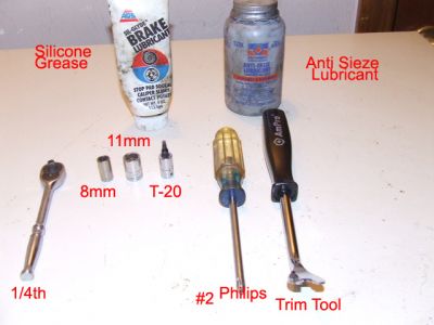

Use the trim tool to pop the anchors in the door...
