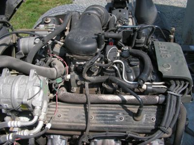

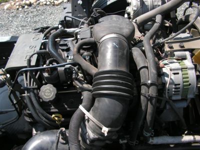

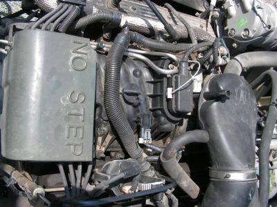

Here is an update on the issue. I still have hesitation but it is about half as bad and more so on when I go from a stop to go with a lighter throttle. Since replacing the IAC valve the vechile has died a total of three times so I think the idle may be a little too low at times. I have noticed that every once in a while I hear the idle kind of surge but then goes away. I have tried to figure out how I can check the vacuum on this vechile but I can't find any place on the intake man. to test for vacuum. I have included some pictures of the motor.

Question. Do you think that the IAC vavle that I just replaced is possibly bad? Or do you think that I may have something else that may also be bad? I'm looking into getting a car repair manual for this vechile looks as if they arn't cheap.
