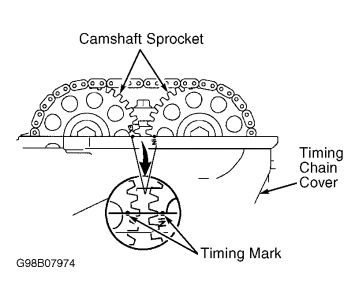

On a 1998 Cheverlot Prizm, what is the timing marks location on the cams?

https://images.2carpros.com/forum/automotive_pictures/108325_18_1.jpg
