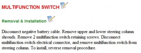

how to replace turn signal switch on an F250 pickup
