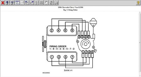

What is the firing order for a 1996 Chevy Step Van 350 engine?
Jan 2, 2010 at 1:38 PM
  • 110,240 POSTS
The firing order is 1-8-4-3-6-5-7-2

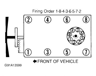

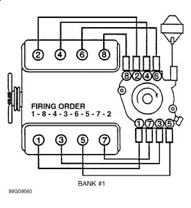

I just remembered there are two different types of distributor caps, so here are pictures of both:
https://images.2carpros.com/forum/automotive_pictures/249084_fire_2.jpg
https://images.2carpros.com/forum/automotive_pictures/249084_fireo_1.jpg
Let me know if you have other questions. Joe
