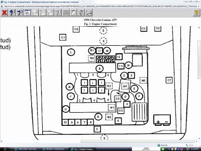

My chevy is a lumina apv. what does code P1652 mean? what do I need to replace?
Thanks

P1652= Cooling fan relay #2...If you posted the engine size in liters and the model of the car, I might be able to tell you it's location...

The P1652 code is on a Chevy Lumina APV, 3.4L V6.

Behind right headlight, at position 7
https://images.2carpros.com/forum/automotive_pictures/62217_FanRelay2_1.jpg
