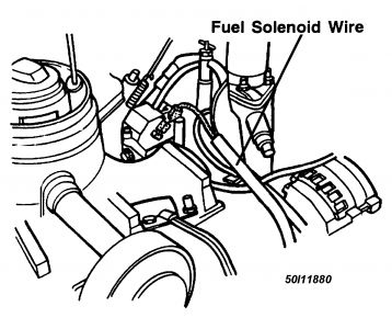

1995 chevrolet 6.5 2500 turbo diesel. Installed a new fuel filter, was running, now it will not start..what do i need to check?

Need to bleed the air out of the fuel system. 1- open bleeder valve on top of filter housing, connect a hose to control fuel flow once it has bled out the air 2- Disconnect the fuel injection pump shutdown solenoid (pink wire) located on the injection pump (see pic)
https://images.2carpros.com/forum/automotive_pictures/1639_chevy_1.jpg
crank the engine in 10-15 second intervals (wait 1 minute in between cranking) to keep from overheating the starter until fuel comes out of the hose. 3- close valve and reconnect solenoid wire, start and let idle for approx 5 minutes
